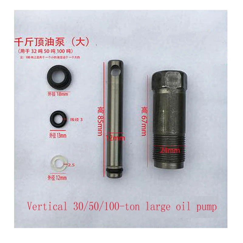

both cherry picker and 3 ton floor jack plunger seals are leaking. Cant find them anywhere so a Google brought me to ALIEXPRESS. Never ordered from ALIEXPRESS although my neighbour has so... they had both identical items I was after. We'll see how they work out once they arrive. This one set me back $2.65 and $8 shipping.
Hydraulic Vertical 100-ton Jack Oil Pump Repair Accessories Small Cylinder Pump Plunger Small Piston Plunger Barrel

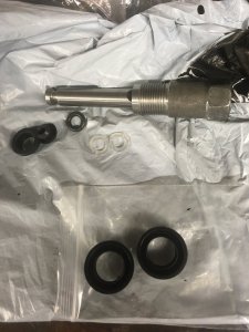

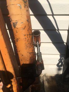

Parts arrived today. Everything installed and fits perfect. No leaks on either floor jack or cherry picker
