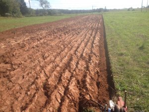

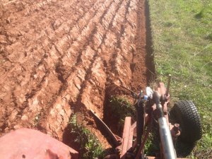

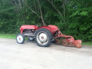

I have a Ferguson two bottom plow. But I can’t tell you what type of mouldboards are on it. It does what I want it to do. I use it for plow matches.

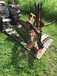

Did some searching. I believe that I have those scotch bottoms on my plow. And I know they are 10”.

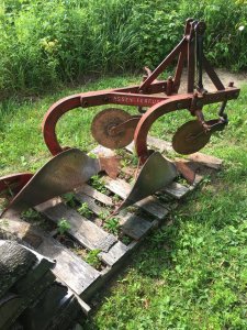

I do not have skimers on my plow. If it did and the same with any plow, the skimers help hide the grass and weeds. The skimer is placed by the coulter and looks like a mini plow. Once the coulter cuts the sod, the skimer flips about a 3” wide mini sod on top of the sod which the main plow is going to turn over. This puts the mini sod at the bottom of the furrow and the main sod covers it.
So if he has skimers. It should help.
I am no expert. Just giving ideas.
That’s what mine looks like.

Yours certainly does a nice job. I cannot see the shares in your photo, they're similar to the one I posted?
I was at the farm today and looked at the plow closely. Seems to be the same one if yours has 10" bottoms.

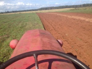

We did the plowing and as I was concerned the scotch bottoms weren't up to the task. In addition to the plow design the tractor was really too wide for that plow. After a bunch of messing around we managed to get it to where it would go as much as 3" deep (sandy loam) in his own furrow and maybe 5" when he was running in someone else's deep furrow. It did turn the soil over more than I expected.
With our general purpose bottoms we were plowing about 8" deep. One of the other participants commented that following that plow was just like opening a new furrow.
He did finally become convinced that's the wrong plow for his tractor and the type of work he's doing. He's started the search for a larger plow with general purpose bottoms.

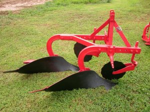

On the Scotch bottom the share or point is only about 1/3 the length of the moldboard. Apparently they're very popular for plow matches.
His plow is similar to this:

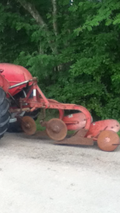

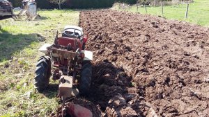

Hi from Scotland the plough shown is for ploughing grassland usually about 5 inch deep if you want to bury trash look for the same type of plough but with semi digger mouldboards and a scotch skimmer to help with the trash keep trying it will work out in the end George S

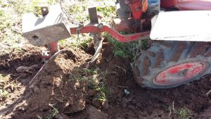

This is my Gutbrod 1032 tractor ploughing with a semi digger plough and a Scotch skimmer for burying the trash ,you are looking for something like this style of plough but 2 furrow

As near as I can tell from your photos your Scotch skimmer is what we call a jointer this side of the pond. My understanding is they are great in sod.
The plow I bought for my Cub came with a Jointer but I haven't used it. The fields we plow are at a dairy farm and they spread manure with straw on them. I use a rolling coulter to cut through that trash. I'm concerned it'd just wad up on the jointer.
