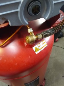

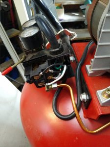

Have you taken the check valve apart at the tank? Sounds like maybe it's somehow stuck, or a blockage somewhere. By pitting your finger over the intake, it prevents any pressure building which locks the pump.
The only thing i have taken apart so far is take the plastic cover off. The check valve is the part that has the 2 lines and the plug at the back that is in the one pic ?
