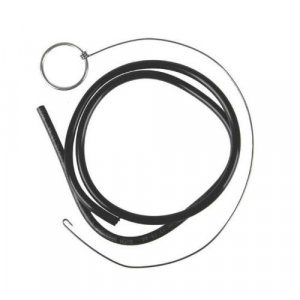

Working on getting this saw running again. It was given to me some time back. Saw the fuel lines were rotten so I started tearing it down for that and a carb clean. Found the adapter between the carb and engine was broken. Ordered in the needed parts, just waing for the adapter and gasket to get here. Putting in the fuel lines was fun. Found that cutting the ends at an angle and smearing wheel bearing grease on them helped. I also used a larger drill bit (by hand) to bevel the holes some. Got about $30 in parts so far, will see how well it runs. Could use a new sprocket and chain yet.
I couldn't get one of those through the hole in the tank due to it being way back in the corner.
