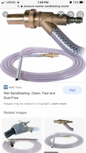

Just wondering if anybody has or uses the pressure washer/sandblasters? I have one of the Princess Auto/Harbor freight cannister pressurized sand blasters which works well just wondering how well these work. Certainly a lot cleaner but not fond of the idea of water on the bare sheet metal. Thoughts?

I would say do one or the other, not both at the same time.
Yeah that would be the plan for sure, I have a homemade sandblasting cabinet and one of the pressure tank styles that I use both with the cabinet and as a stand alone unit, I’m just curious how will these work. I can order just the nozzle on eBay for 30 bucks think it’s well worth a try. I have hose & a suction tube so I might get one.
No I use my pressure feed in through the side of an old oil tank converted into a cabinet. Yeah I’m a little leary of the siphon feed being finicky but we’ll see.
I have the siphon feed sand blast gun that I use the black media in from Menard's'. The hose attaches to a tube at the bottom of the tank. Works a lot better on heavy covered stuff if I hang the tank up about 5' off the ground but goes through the media a lot faster too.

Definitely have thought about getting one of those pressure washer blasters! I've got a good pressure washer and a portable sandblaster---BUT I still can't swing the bucks for a compressor that can handle the sandblaster! A friend gave me the blaster a long time ago. Then one more issue is where I can make a designated blasting place. I can figure the last one if I could get one of the other two variables---LOL! Right now, the pressure washer blaster seems like the most affordable. From what I have read about them the flash surface rust is dealt with pretty easily.
You rinse the freshly blasted surface with baking soda solution to neutralize surface.
