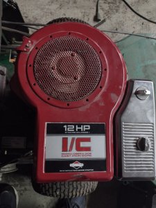

just got this yesterday, got unloaded from the bed of my truck today/ Dug the engine that I plan to run on it, out from the shed. Looks like it "grew" there, like it belongs. have to mount it "sideways" as Briggs L head engines go, with head to right side (from operator position) and muffler and carb to front, so one of the existing sets of engine mount bolts lines up. like I used to see, on what are now "much older" versions of this same mower. Gee, I must be gettin old.

Have a brand new 281707 (something like that, should've wrote it down) 12HP I/C Briggs for it, code number starts with "88" (year) but this engine has never had gas or oil in it.... I was worried about the PTO clutch fitting/ being as how I am replacing a dead Kawi and being (mainly) Japanese origins, I was thinking that the crankshaft might have been metric diameter. Surprisingly not. Same 1" dia as my Briggs. which is great.

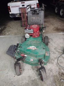

Well hopefully here's a picture of what I'm talking about. Engine is bolted on but that's it so far. Nothing hooked up yet.IMG_20210810_204519160.jpg on the 3rd pic you can see some "shelf wear" from 33 years of being shuffled around... oops. IMG_20210810_204546189_HDR.jpgIMG_20210810_205051153.jpg
