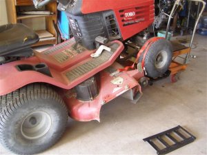

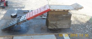

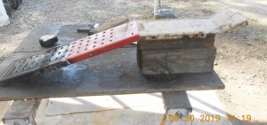

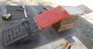

Been thinking about this for a while. Have a project coming up that these would work better than my lift as I would not have the center part of the lift in the way of what I want to do. These are GT footrests I have taken off parted tractors. The ramp is 26" long. May shorten the upper flat section. Trying to decide what height to make them. 1st pic is 12", last is 8.5".

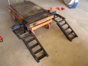

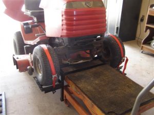

Made this up for my hyd lift table. When the front wheels are strapped down, if needed I can jack up the rear and set the tires on milk crates. I have found so many uses for this lift table. Made an extension to make it wider for some push mowers. Strap stacked milk crates on it as a rest when cutting up 20 ft steel with the chop saw. Being rated for 1,000 lbs I set my 700 lb welder on it when refurbishing it. It's just been a handy helper for me.
View attachment 17968 View attachment 17969 View attachment 17970
I'd say the height is dependent on how low you can go to get under it. For me, higher is better!
I love those lift tables like Mike has. We have a couple of them at work and they do a lot of what would be back-breaking labor! I have never cut loose with some bucks for one here in my shop though. Very creative coming up with that wheel lift attachment for it Mike!

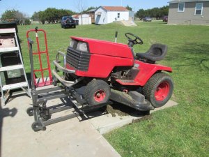

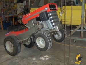

I built a gantry crane about 15 years ago so my method is about like Roger's except I keep the crane in the shop, or can roll it outside.
Since I have no available 'sky hooks', I am reduced to supporting things from the ground up. Just trying to find a way that doesn't have the 'lift' mechanism right in the wrong place!
