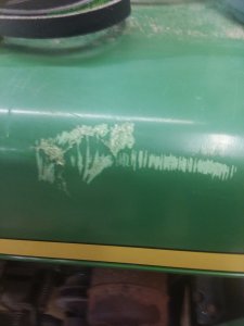

They make a bondo type stuff with the fiberglass strands in it. Is it broken all the way through?

I’d just DA the hood down and use regular light filler. The marks on that
Don look like the ones that were on my 210 I just painted. A light skin coat will make quick work of it. . Better cover that hood decal up good though. They are NLA .
