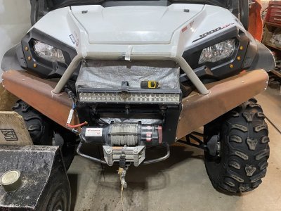

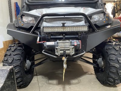

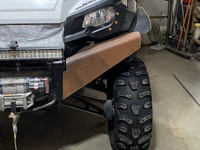

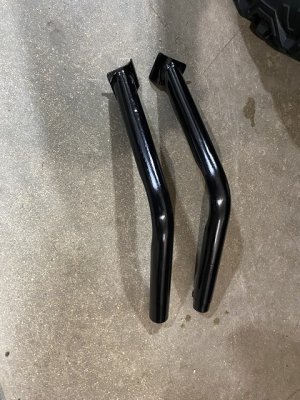

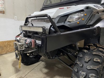

Built this light duty Bumper for my side x side using the hood off the plunger cover of a 270 New Holland square baler . The Tubing is the side handles off a tread mill.

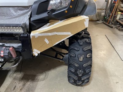

Started with a cereal box as a template and this is what the end result is. This is pretty much bolt together except where I welded the tubing to the small bolt on brackets.
