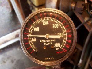

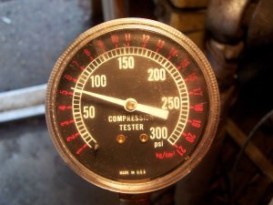

I did a compression check and got 65 lbs. cold and 75 lbs hot.

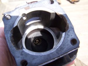

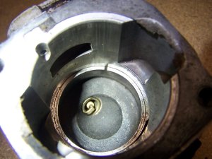

I pulled the cylinder and found the bore in good shape. When I inspected the ring, it felt weak and after squaring it up in the bore it had .060" end gap.

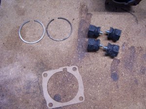

I ordered a new ring, gasket, and rubber mounts for it and they arrived today. Check the fit of the new ring it has way more tension and the end gap is .014". Hope this will get this saw running well again.
