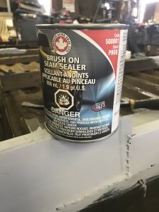

This is the seam sealer I’m gunna use. Is this the same as what you use in tubes Jazz ?
I've used the Dominion Sure Seal in the cartridge. Never used the stuff in a tin like that so I'm not sure if its the same viscosity.

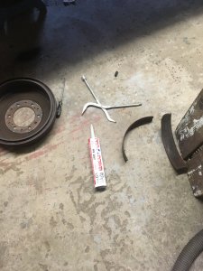

Found issue with brake locked up on Toyota truck,,,pads had come loose, fell off when I removed drum
