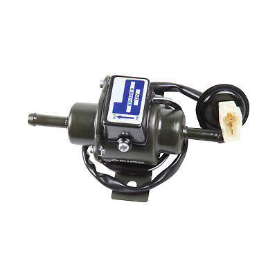

They are known for having a weak fuel pump when I had mine I got tired of those starting problems and installed a low pressure electric pump worked good, another question is there an inline fuel filter if so its not recommended on them there is a fuel screen as part of the tank outlet connection. If you decide to go with the electric pump the carb/fuel pump needs to be disabled by disconnecting the crankcase pulse line and capping it off
You say low pressure fuel pump.
How low is low ?
I used a 3 to 5 psi pump if want one to out last the SS16 buy a Facet but the off shore one work and sometimes you get one that last and others don't
How low is low ?
I use a facet on my cub 682. Got it from NAPA. Been on there about 8 years.
