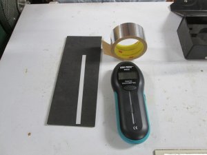

I checked my HF phototach against a 1750 RPM electric motor and it was dead on. How do I know for sure the motor was turning at that RPM? If an electric motor is running on 60hz current it will be running at the advertised RPM.
On the laser it comes with aluminum strips that can be placed on flywheels, belt pullies, fan blades, etc. can measure almost anything that spins.

Never seen one of those, and doubt that I’ll ever have one. Seems like the thing to get. Again. Portable, but have the strips of stuff with ya.
Pretty cheep and good for what it does. If worried about running out od the reflective strips I found the 3M aluminum tape works well.
I was just wondering what you did when you ran out of the stickers. Glad to know you're not stuck buying more from them.

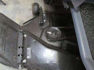

The front wheels used to run into the mower deck, so I figured I would modify it a little bit, make a couple of recessed spots. Got it cut and bent some and figured I better check it out before I get too far along. Put it on the tractor and turned the wheels, they don't come close now, but not because of my modifications, oh no!!!
Seems that the axle must have been installed on the old tractor so that it was positioned more to the rear. Well when I removed it from the old front frame section, and installed it on the new one, i positioned it so that it was more to the front.
If I had only checked the deck first before I modified it, I would have seen that it wasn't necessary to modify anything. So now I have to weld up my deck where I cut and bent it.
