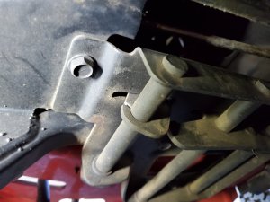

Also, as I was pulling myself out from underneath I noticed a crack in one of the levers, see pic. The lever is part of the parking brake pedal, so I wonder if that is my issue.

Tried backing the nut off and no change. I think the problem is with the crack in the linkage. I might have to take it all off and have it welded back together.
