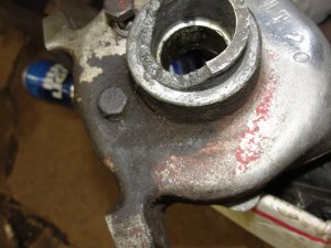

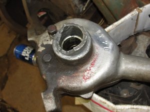

Looking for a steering gear box like this. preferably in better shape.
Doug, what's it from or at least what year range?
I know much of your stuff is unique, so there may not be many of that particular model out there.
It is most likely a Haney built in the 40s. The early Haneys used Western engines and this has WT20 cast into the box. I'm thinking it was built by Western too. Most likely, if anybody has one they won't know what it fits. The ad pics I've seen for the Haney doesn't even show this box. I'll most likely end up having to fix this one but never hurts to throw it out there.

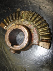

That steering gear is repairable. I had one in worse shape, had a welding shop weld beads where the teeth were to be. Cut a grove in between and then several evenings with the 3 sided file working each tooth down to where it looked even. Put it back in the tractor and it works great.
