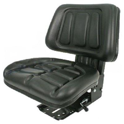

For those who may be interested in a little better ride. Here's two that I use. First picture is one I have on a Zero Turn front mount Woods. The second is just the suspension added to the existing seat on my Yanmar tractor. Thought you guys would like to take a look.
The suspension seat is pricey at around $350.
Just the suspension shown is around $125.
Both do their job and make a noticeable difference.I
Neither were direct bolt on but with a little fab work they came out well.
How much does the suspension system raise the seat? Shorter person may not be able to reach the foot control?
That's where you got to be a little inventive.
The suspension seat that I put on the zero turn I had to add 1" x 3 tubing to make the height I needed.
The one on the tractor I had to remake everything.
takes some doing but worth it. At least thats what my back and my a## tells me..
Installed one similar to this on the fordson Dexta and really like it.
