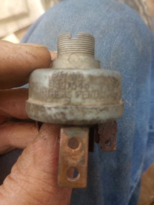

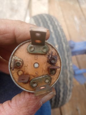

A lot of those are still available but you have to compare them with what you have making sure the terminals are lining up the same way. Post your part that you want in here you might get a better response.

i guarantee that switch is still available. You dont need to look for it as a "Sears Suburban" part. INDAK made all the ignition switches for a gazillion makes and models. Look somewhere like Jacks small engine or PSEP (Pats small engine parts) they are listed by the terminal callout on the back side.
