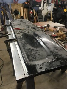

I knew the 2 small rust spots would reveal more…and i had no sheet metal so sprung for a full sheet of 20 gauge @$125 a sheet. My last half sheet lasted me 7 years,,,most of it got used to fix floor of a ford..

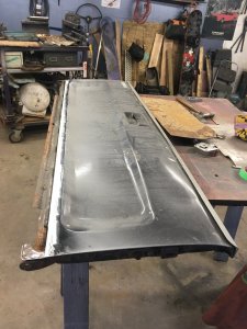

I ran sheet metal through bead roller so as not to have to butt weld the seam. Bent lower seam over with my 30” break so had to use two pieces of tin as the tailgate is 54”
This all started with the tailgate being loose,,the weld nuts had broke loose from body and they act as part of the hinge so new nuts welded in,,,this has been on my bucket list for a couple years,,,,booked the week off so have to accomplish something32046AD1-F65E-4961-BA62-82BF2077629F.jpeg
