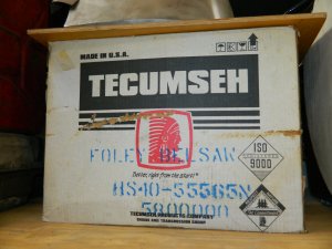

Just saw a new in box HS40 at a garage sale earlier today. Writing of price on box was sloppy wasn't sure if they want $50 or $150.
