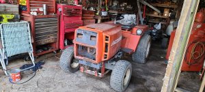

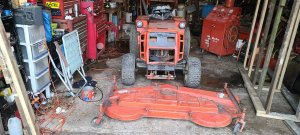

I hauled the big Jacobsen 53500 home today along with a rough 1970 110 Deere patio tractor and a Electric lift for a Simplicity / Allis tractors.

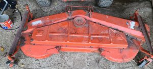

The Jake came with a 60 inch deck and 3 point hitch.
It appears to be a low hour machine by the normal wear areas.
I believe it will clean up very nice and make a good original example.

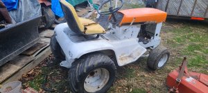

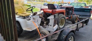

The rough JD 110 Patio and the Simplicity/Allis electric lift.
All this stuff came from a buddy that I have been trading tractor stuff back and fourth with for years.

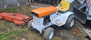

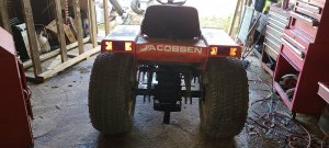

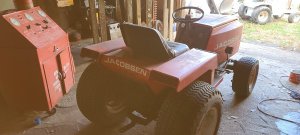

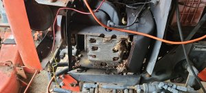

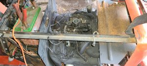

The Big Jake runs !
I hauled it home with no real idea what it needed.
With a little tinkering it's a runner !

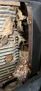

I cleaned the mouse nesting out of the blower housing,

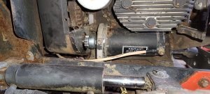

The starter was loose and rotated wrong.
The engine to frame ground was gone.
So Rectified those two issues,cleaned the points,added gas line and blew backwards into the tank with the compressor and it fired up and ran strong. Oil pressure gauge shows 50+ psi.
I didn't get it out of the shop to try driving it yet.
I hope to get the tractor back together and go for a test drive tomorrow.
