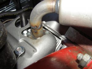

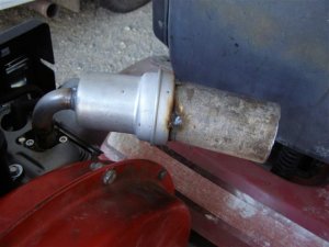

Received the briggs today and all the holes lined up but the exhaust was blowing on the back of the seat. I removed the exhaust , cut the vertical section and rotated it as far as I could. Still wasn't quite enough so added a piece of exhaust pipe cut off at an angle. This made the heat shield unusable but if I get burned that'll be on me. Later I'll make a support bracket from the rotor housing up to the pipe addition. I think this will work fine. It's ready to vac up lawn thatch in the spring.
