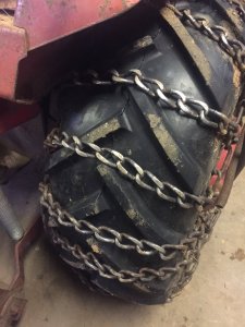

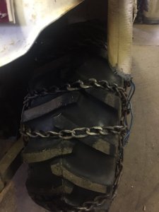

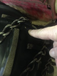

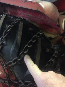

Chains may fall in between the lugs on the sides of the tire, but still grab like the tire lug. But the chain in the centre of the tire is on top of the lug. A lot of pressure on that short piece of chain that’s digging in to the surface of what your driving on, giving quite a bite. Chains should be just alittle loose to give best traction.
Duals are good for a loader as mentioned. And if the duals are loaded, gives better counter weigh and traction when the bucket is full.
chieffan
Good point to run the chains a bit loose for better traction. Have seen a lot of chains pulled tight with bungee cords, etc. Take up a side link if they are that loose but running chains fiddle string tight defeats half the purpose. Chains on farm tractorts are run just snug enough to keep them on the tire.
