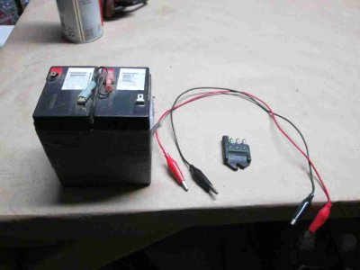

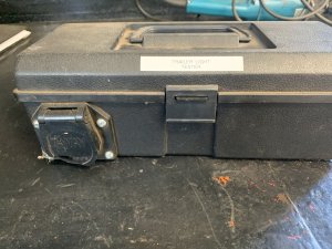

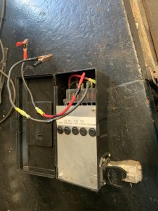

I made this a few years ago had it out today fixing the neighbours trailer thought I’d throw it on here. Works great for testing trailer lighting without having to have a vehicle hooked up. Just a little plastic toolbox couple signal light flashers little fuse box and switches. Maybe 15 bucks in parts, saves a lot of hassle. Hooks up to a battery. Funny thing was I used it on his trailer to install new lights. plugged the trailer into his truck before he left and got him to try it and he had blown a fuse while playing around with the old lights glad I got him a check before he left lol. Newer truck so even smaller micro fuses.

Very useful piece of equipment. Do you happen to have a schematic for the wiring of this gem? Would sure like to build one. Could probably figure it out but be easier if you have that part done already.

My tester uses the seven pin but I have a 4 to 7 pin adapter to test 4 pin system. I like being able to turn on a signal light & brakes on the opposite side at the same time. It helps when chasing a bad ground. With the tester you can turn on what ever you want & walk around the trailer to check.
That is what I was thinking too Jason. Can control which ever light(s) you want. This trailer don't have any lights other than the standard tail stop/turn signals lights. My add a couple on the leading edge of the fenders but living on gravel road not sure how long they would last. First rock threw up by the tire it would be destroyed. Be alot of work to put a rack grill in front of them. Never did loose on on my big trailer though.
