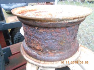

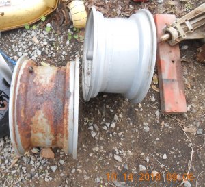

It's Slime or similar product. Has a fine layer of a paper type goo all over the wheels. Some I have taken apart still had a green tint in it. Wheels were super rusty inside. Very pitted! I have a couple wheels I can take pics of that had this goo in them!

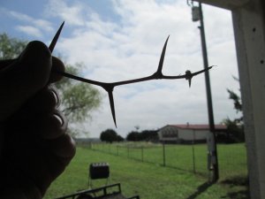

Tubeless here, no slime, only plugs used when I get a mesquite thorn. What makes a difference is 4-ply vs. 2-ply. Never had an issue with the catcus.
Here's a couple pics of wheels I have taken tires off that had a green liquid & the paper looking substance tucks to everything. Had to use a scrub brush inside the tires to put tubes in them.
These may have had Slime in them for quite some time before I got them!
