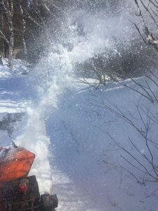

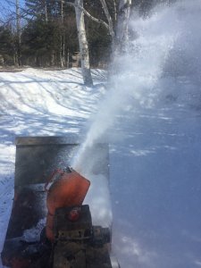

Yep. I have one. I never figured out the reason why it’s made that way. My dad bought this in 1969 used. It’s a 1968 model. Moved a lot of snow with that machine.
I try and get it out once a year to keep it running. Was just thinking this week about getting it out for it’s run. A little snow coming today. So maybe tomorrow.

I'm not a snow blower expert by any stretch. On my blower the engine crankshaft points frontward so there is a gear box at the auger to turn the power transmission 90 degrees.
On those blowers the crankshaft is crosswise so all the rotating shafts are parallel. It won't require a power hogging gear box at the auger. I wouldn't be surprised if the entire drive line is chains and/or belts.
When I first saw it, I thought it could have a reduced capacity since it feeds from a smaller area of the fan compared to the ordinary full open face. But then I thought with feeding on the edge of the fan it hits the edge of the paddle where it needs to be. So Noel, can you tell us how it does?
It is run by belt and chains. Well Shorty , depending on the type of snow it might throw 20’ or so. Not as good as some of today’s designs, but it does the job. It’s heavy compared to today’s blowers. Dads is a 8 hp 26” cut. I think most were smaller. 5 hp and 24” cut maybe. You can see the extension, on the front bucket, I put on it years ago, so that kind of gives you the idea of the amount of snow we were in. Man, that old thing did a lot of work.

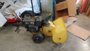

Well, I found out the answer. a year after last posting here. I bought one like that, 2 or 3 weeks ago. Saw it on CL over the summer and realized it was only a few miles away.
Bob Cat brand, I occasionally ran across the ad and figured "I got plenty of snow handling equip", especially since for the most part we haven't been getting the snow we did in the late 70s/early 80s around here. And I have that Ariens GT with the huge 4 foot blower. except this year I don't. And after a couple of winters of not even needing a snow blade or blower, (maybe once a year) and we got any snow of consequence, my 2 cycle paddle style has been more than enough for the job. We're making up for it this season, in a big way.

Mine has a 7hp Briggs L head, built in 1980. Most certainly the original engine. 1st 2 stage walk behind that I've had with something besides a Tecumseh Snow King, an engine I really like (as long as they have an adjustable carb on them!!)
This is the heaviest 24-28" 2 stage snow blower I have ever run. lotsa mass, and the chassis itself is "long" compared to other snowblowers that are this width. I have quickly discovered how much that actually helps traction, and actually digging in/ instead of wanting to walk on top of the concrete.
