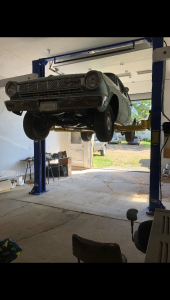

Hehe. Son put the rambler up on the new hoist yesterday. Hoists are such a great thing. But you then see things much easier. And the rambler has a few more bubbles than we thought. So a fix rust and repaint may happen in a couple of years.

I don't work on vehicles much any more. Got to be an easy to get to thing or it goes to the shop. My mower lift is the biggest lift I need. Post lifts are a big improvement over the old drive on ramp type, but still a lot of them in use yet.
I can see why your son raised the ceiling. That hoist was a fug snit. Hoist would be nice. I've thought about getting one of those to work on June Bug with but so far it hasn't happened.

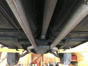

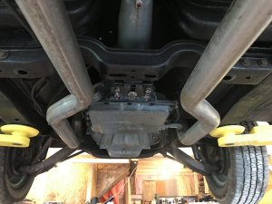

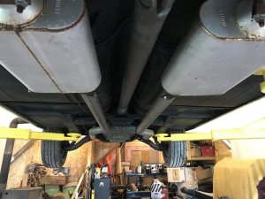

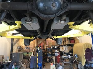

Some under car pictures, of the Rambler. We are hope fully gunna try to put tail pipes on. If we can’t do it we will take it to a shop. We did the front pipes, while laying on the door under the car. Used a wire and bent the wire to shape we needed, then went to the muffler shop and got the pipe bent the same as the wire. Worked good. Hoist will make it much easier to do tailpipes.

Yeah I'm even more jealous now seeing the Rambler up on the lift! Looks like the Rambler was well undercoated! Glad the wire pattern worked out well! I think every shop in town here would just say bring the car or go away!

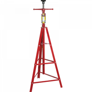

We were taught to lift the car about 3 or 4 feel and shake the crap out of it themn finish lifting it and set the jack stands in place. Our Jack stands were tri post with a adjustable center screw.
Simular to this one but ours were made with 1/12 pipe, heavy but high capisity.
