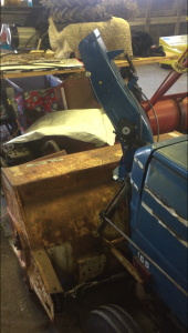

Upgrade to snowthrower.
On the LGT 165 Ford. Added an electric power top chute defector. Just as fast as the hydraulic one on my JD 140 H3. Snow storm tomorrow, so I should be able to test it out.

So, about 10/12” of snow today. Used the ford and the chute modification worked great. Nice to place the snow where you want , when you want.
