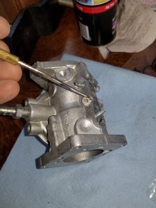

How do I replace the Jets that I'm pointing to in the picture? Any ideas?

Is this a WHG 28-A? What it looks like is a fixed jet model? The small brass plugs are like common freeze plugs? Is the tip of that tool pointing at a precision drilled hole to vent?
Sorry, been very busy and not been able to look at the carb. It is a whg 16b2150 . I got the carb it for it from amazon and it comes with a new needle, bowl gasket, two welch plugs, gasket, bowl nut gasket, pin, and two brass plugs. It is on a Tecumseh OH160 170084F 13231

The tip of your tool would not be a jet but a small brass plug. Are you trying to remove the brass plug? Are you running into a function problem with the new carb and want to make sure all passages are clean? Or attempting a deep clean?
Thanks for checking in! I have not solved this yet as I have been busy with work. Yes, the brass plugs are the ones in question. The carb needed cleaning when I got it so I figured I would replace all parts to get it going after putting it through a good cleaning. Once I get the need needle in I am going to give it a go without replacing the plugs and welch plugs in hopes that I don't have to touch them.
