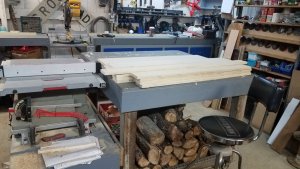

I've been waiting & searching for a metal cabinet to go under my table. A lot of good buys but most wouldn't fit or not the right one.

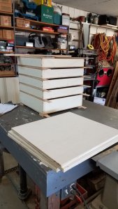

I had some scraps left over from some other cabinets I built. I designed the cabinet around the drawers since I had a good idea what I was going to use them for...right angle grinder discs, orbital sander pads, & hardware so far.

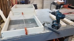

I cut all the drawer boxes up, nothing fancy just simple & quick.

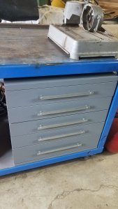

I'm using 20" 100lb. ball bearing drawer slides. I sized up all the drawers then measured for the cabinet.
I had some 1/8"x 1" zinc coated flat bar stock I'll use for the handles. I started to paint these but sometimes a 60 grit sander pad puts a nice swirly pattern that looks good. I sprayed a clear coat on them & used some plastic spacers I had from somewhere.
I painted it gray & might put a semi gloss clear coat on it so I can easily wipe the dirt off.

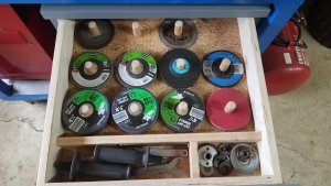

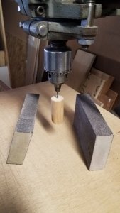

The top drawer I used a salvaged broom stick for dowels to hold the discs. The dowels had to be slightly smaller to fit the discs. I ran them in my drill press & held sanding blocks on each side.

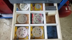

The second drawer holds all the orbital sander pads.

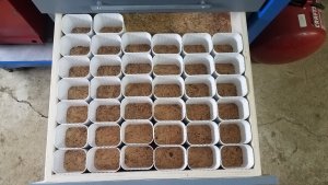

The third drawer will hold some various nuts, bolts, & washers. I seen a guy on YouTube cut sections of plastic downspout. He stapled plywood bottoms on his but I didnt like that. I have some sheets of pvc I'm going to line the drawer bottom with then use pvc glue & plastic weld the boxes to the bottom.
I'm thinking about hanging my grinders on the side of the cabinet for a next project. Thanks for viewing!

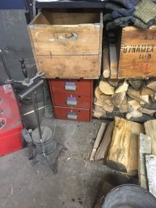

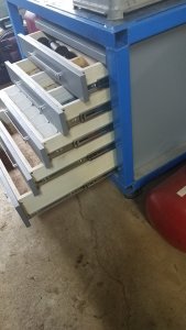

I had picked up this small cabinet with intentions of putting it into my welding table but it just never happened. So many metal cabinets went to scrapyards due to modern filing methods.

Cabinet looks great! I never gravitated to woodwork.

That looks sharp! My only concern would be the use of wood under a welding table being a fire hazard. Those sparks get into everything.
Although I weld on the other side I have the same safety concerns too. I have some small galvanized sheets salvaged from a neighbors heat ducts. I'm thinking of wrapping the back side with that. I weld mostly outside next to my shop. Once I split my shop up between wood & metal projects things will be better. My idea is similar to the way you extended your shop. I'm at 20' wide x 29' long right now. I want to open the back wall for just passage & extend out another 16'.

That red cabinet you got is what I was looking for. Everything I found had the two or three large drawers. I've had sawdust in my veins since birth. Metal working has been my new challenge since I got involved with garden tractors. Following all the build & repair threads keeps my mind occupied.

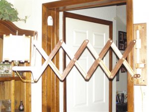

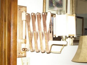

Attached is pics of a lamp a very good friend made me for Christmas. All but the hardware and wire is hand made. He even makes the framing for the shade. He figures he has about 100 hrs in each lamp and this is the 9th one he's made. A true wood craftsman!!

I like the way your friend made the mount on the wall. The upper arm has to slide up & down.
