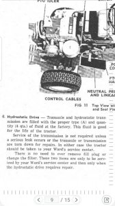

Does anyone have a part number for a hydro filter for a 72 Gilson S15 with a Vickers hydro ?
The manual gives very little info.
It says the filter and fluid are good for the life of the tractor and to only let a dealer do it lol.
While the Vickers is still strong and smooth,I'm sure a fluid and filter change wouldn't hurt this 48 year old tractor.
The manual does say that it takes four quarts of fluid but until I open the drain,I'm not sure what fluid.

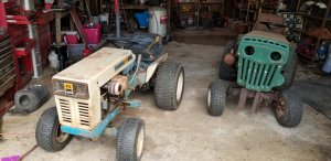

Well that's not encouraging.
I'm sure I can take the filter off and cross reference it with other filters. Was just hoping to do it an easier way without taking the filter off while I research and keep the tractor operable.
