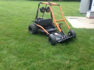

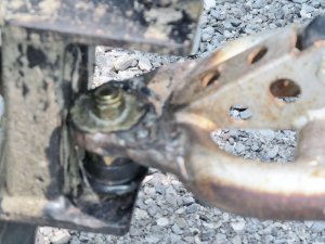

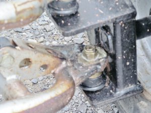

So I babysat the grandkids this week and we needed something fun to do.. I broke out the Yerf Dog Spiderbox and we all terrorized the neighborhood on it! For some reason the thing doesn't know how to drive in a straight line and turns and drifts all over the place! :confused: Things were going great this week and the kids loved it but on Wed things came to a screeching halt.. Both front lower ball joints separated from the A-arms at the same time.. :mad:.. I got out the 4310 and dragged the thing back home to the barn and pulled both arms off and contemplated what to do to remedy the situation.. I poked around the web for replacements and after seeing the parts and the same chincy design I came up with something cheaper and more... robust.. I reformed the busted mounts with the vise & hammer then welded all the mounting washers onto the arms.. Then the welds were expanded to the arms themselves.. Next time we have a problem the arms or the ball joints will fail! My grandson & I put the thing back together and we proceeded to test the thing out and it performed excellently! :):cool:

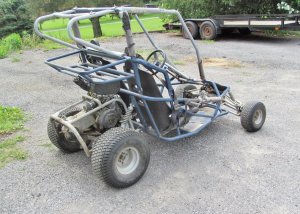

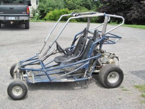

I see yours at least suspension on all 4 side Tink.
Mine will rupture your kidneys !!!!!
Got ya...mono shock like ?
Thought about it more I know what you mean..:)
Dual shocks with one pivot point on the back.. The front end takes a beating with my fat ass on it! It goes about 30+ MPH and there has been many powerslides! (for some reason when I turn right the thing gets a tad tippy) My grand daughter seems to have the black cloud because every time it broke she was on it with me! I don't know why there is a storage rack on the back because nothing would stay up there for long! (I wouldn't want to drink beer that was up there!) My grandson wants to drive it but I fear for his safety and also the front suspension if he hit's something.. It has a mind of it's own when trying to turn it sometimes.. The straight rear axle makes the thing just want to go straight..
