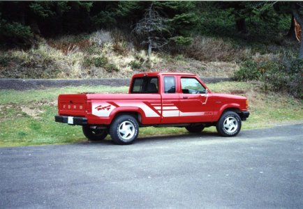

I had a 91 base model 4x4. Bought it in 2002. It was a good truck. I drove it for a few months and put it up for sale. Sold it to a guy that lived a few houses up from my dad. He drove that truck for 12 more years. The body mounts rotted off, the bed floor rotted out. The truck looked like it was bent in a V. He claimed it ran like a champ still. He passed away in 2014. It sat in the yard of his house till 2019 when it was finally scrapped!
Got any picture of it?
The body and frame holding up pretty good for you ?
Some reason I didn't think they had the 4.0 back then....?
Body is in good shape. Never used to get salt on the roads in winter around here. Now they put some on but I am not driving in it every day. The red paint is really faded. Guess I need to talk with my painter. It needs a new windshield and the sagging headliner fabric glued back down to the molded backing. Already bought the new clutch and hope to get it in this winter once I clear a spot for it in the shop.
1st pic was just after I bought it. The second may have been about 10 yrs ago but its about the same today if I wash it up good.
Nice...
Did they made that cab and 1/2 with rear doors that opened back then ?
