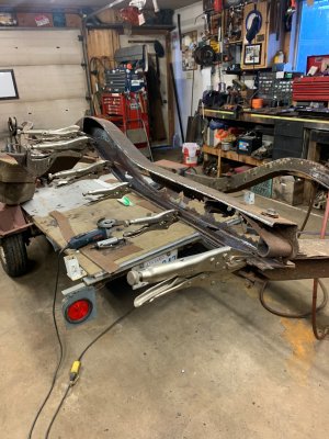

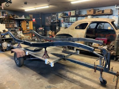

I am going to cut a couple holes on top of frame to remove the debris…then blow it out with air before rinsing interior of frame with rust treatment..the worst area at the left rear will be replaced completely,,which will be a bit tedious but i work cheap.

Cut out steel till it’s all correct thickness. One pinhole is a 16” X 2” hole now. I’ll also remove some of bottom plate to reinforce any patches on side rail of frame
Bottom plate is riveted on. Picked up a little piece of scrap to start patching
