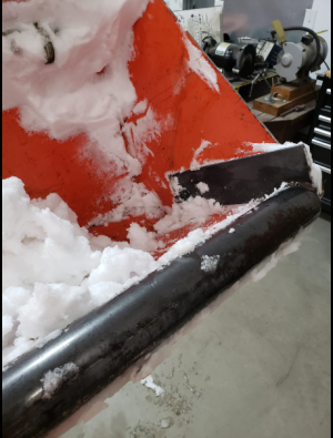

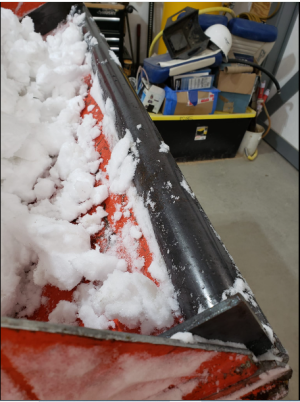

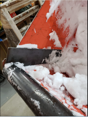

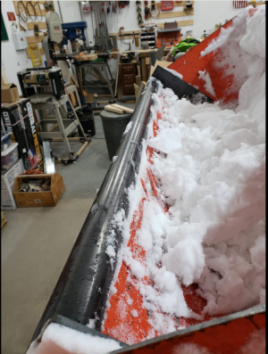

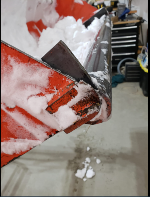

Used to use PVC on the bucket edge of our Kubota B2620 for pushing snow on our gravel drive and grass area. In the cold if you hit ice it will shatter. Got tired of replacing it so my neighbor and I got some 2" pipe that was slotted and welded brackets to it and bolted it to the bucket. Best decision we made. Works great.

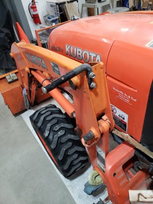

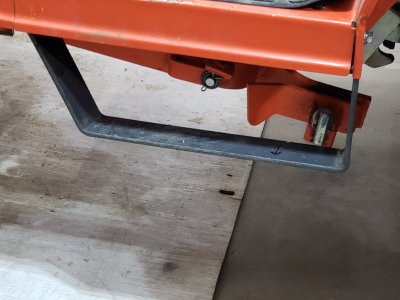

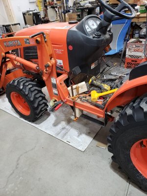

I also built a handle for the loader to grab to get on instead of pulling on the steering wheel. Along with that I made a step to make it easier my old bones getting on and off the tractor. Wife was happy also.

Nice work, Roger! Many years ago I built a full length round tube skid on the blade of my snow pusher, the MF8E. I call it a driveway saver. The round skids at each end of the blade would gouge the gravel bad. The long one still shoves a bit of gravel into the grass but no gouges any more.
