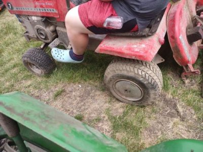

Yesterday I spent all day at a large consignment auction, there were 2 auction rings running most of the day. Quite a few items I was interested when higher than what I was willing to pay and some stuff went real cheap. I mainly was interested in MF7 they had which included mowing deck and snowblower. output_image1686484771744.jpg The tractor was all original, the front trim ring was fully intact. I do not know if it ran or not. It did have 3 of the 4 hub caps on the wheels. output_image1686484802678.jpg. It went for $300, I did not bring it home for that price.
