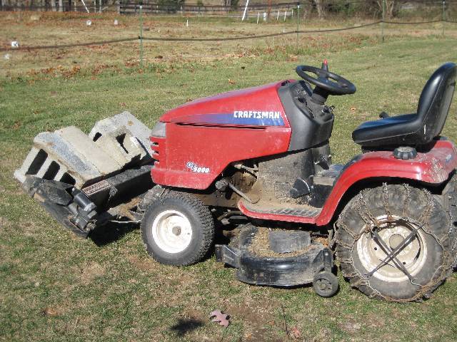

I got to thinking about what "capable" means, as it refers to a Garden Tractor, and this came to mind;
Though there are many implements being built for our Garden Tractors, I will look at the front scoop for today.
The front scoop, verses a bucket loader is a unique ground engagement Garden Tractor implement that is designed for light loads and limited capabilities that keep the load below or at the chassis height. This allows the use of a Garden Tractor to move fill verses a wheel barrow and not go too far above the GT's center of gravity and negatively effect the equipment's design strength and capability.

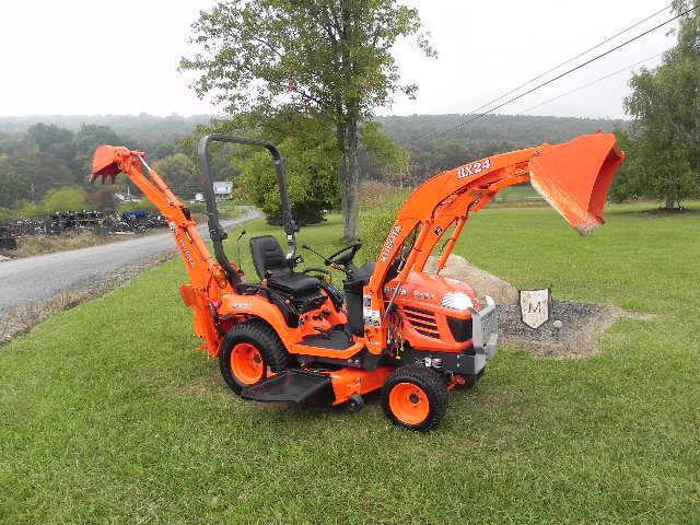

A quick look at the bucket loader for comparison;
Bucket loaders are designed to go above the tractor chassis, requiring much more chassis engineering to handle the raising of the center of gravity over the chassis and potentially the tractor.

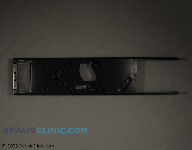

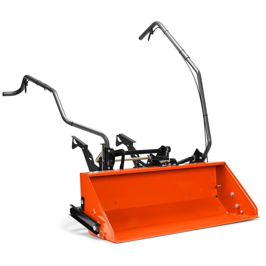

The Agri-Fab built for Husqvarna front scoop, model #588181401 (Agri-fab #05-04031 and succession)-(36") Bucket part #64962. I'm still including because there maybe some still out there for sale, but looks as if discontinued for Husqvarna now. Here it is;
The Husqvarna branded Agri-Fab scoop started as a 42" wide bucket, with the same limitations, near as I have been able to find, as early as 2006. 2006 is also the first time I can find the GT/TS pan style chassis being used by Husqvarna.
And it wasn't in a Garden Tractor, Husqvarna still used c-channel welded chassis in their Garden Tractor's then. Who knew husqvarna would keep adding holes and adding the lawn mower chassis in the top Garden Tractors within a couple years, it was a deluxe riding lawn mower (you won't find it on tractor data, but but you will on Husqvarna.com);
Number#96043000300

Husqvarna 36" front scoop:
1) 36" w x 14" L x 12" H - Volume= 1.7 cubic feet or 12.7 US Gallons.
A) If moving dirt at 80lbs per cubic foot= that's a total of 136lbs.....This scoop full is 64lbs under weight limit.
B) If moving sand or rock at 100lbs per cubic foot= that's a total of 170lbs.. and 30lbs under the 200lbs weight limit.
2) Maximum lift above ground- 7"
3) $629.99 MSRP
4) Requires or is recommended:
A) Wheel Weight
B) Tire Chains
5) Maximum allowable speed when attached- unknown
6) Unknown mounting options- appears to be unavailable
7) 2 year warranty on the scoop only, not use on your tractor.
8) 200lb maximum weight capacity.
42" Husqvarna front scoop: Unavailable. sold 2006-2008?
