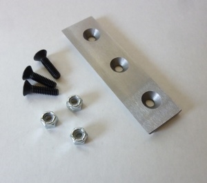

If you need to replace your chipper blade this is where I got mine.

chipper blade is actually in quite good shape. found that replacement blade for $5- cheaper shipping from chalmers own account on ebay so i ordered one. pillow blocks are on the way.
