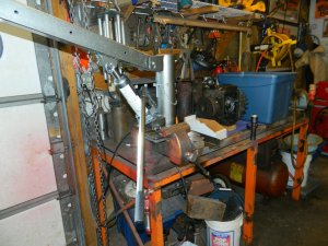

Very good!! Now just mount a rigid pulley on the end and a boat winch near the base and then you can make straight picks instead of arcing picks.
I have the stuff to do that too! I might try to set it up to go either way!Very good!! Now just mount a rigid pulley on the end and a boat winch near the base and then you can make straight picks instead of arcing picks.
It might get an extension added to it for some uses, to make it a bit "taller". Probably something like you may have done , Kenny!I have one of those. Made a base similar to an engine hoist, just not as heavy duty. Works great for the GT's!
That's a good point Don! Better re-think that!Most boat trailer winches only ratchet in one direction making it dangerous to lower a load that can free fall. If you lose your grip the handle can slap you several times very quickly.
Don
You can get them to ratchet both both ways, the one I have on my trailer does. Its from Princess Auto though. Just make sure the description says reversible.That's a good point Don! Better re-think that!
