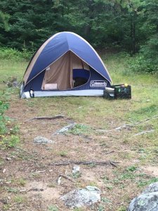

I have a couple of Coleman premium 3 women tents. 20 years now they withstood high winds, few inches of flash flooding rolling through campsite,,tent contents stayed dry. Very durable.

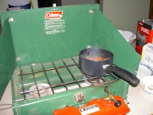

I doubt that this is a 201, but it's still my emergency light if the power goes out. I know it is at least 50 years old, still works great. I fire it up every fall in case of a blizzard as well as the Coleman stove.
It's pretty amazing that the "white gas naptha" Coleman fuel stays fresh for decades, and gasoline can spoil in a gas can in a matter of months!

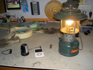

Well I have had all of my lanterns out and lit last week except for 2. One is fighting me, being a PITA, don't wanna light. About a year and a half ago I played with it and no success so I put it aside. Just tried it again last week and it would light and die. Light and die. So I have it all the way apart this time. Previously I had replaced the generator tube, the packing on the valve nut and the leather pump cup.
This is the 1st time I've had a valve unscrewed from the tank, this one was sooted/carboned up at the very bottom
I put it thru the ultrasonic cleaner and that cleaned it right up. I ordered a new filler cap since I borrowed the one that came from it for another that had a bad oring seal and a new check valve along with the tool to R&R the check valves from feebay just in case.
