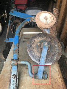

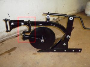

I need a coulter standard for an old Brinley/Simplicity plow.
It is the bent shaft in the red outline.
I can replicate it it anyone has the dimensions.

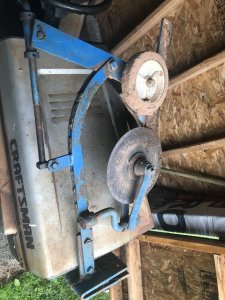

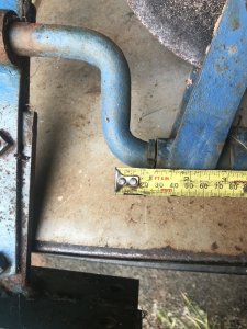

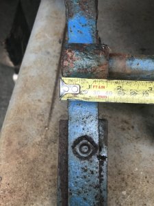

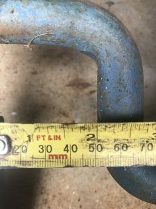

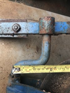

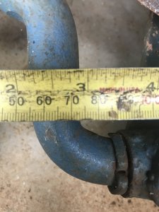

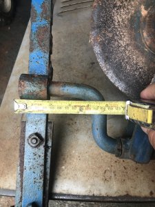

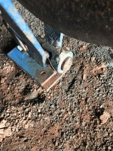

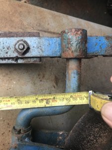

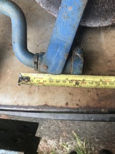

Found it. I think it’s the same as your picture.
7/8” bar. Top down to first bend 4.5” to centre of bend, then centre of bend to centre of bend 3”, then centre of last bend down to end is 4”.
If you need more information or pictures let me know.

Thank you very much!!:):thumbs::)

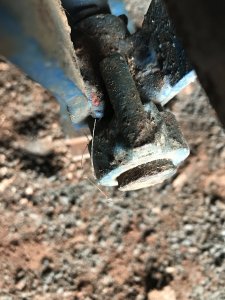

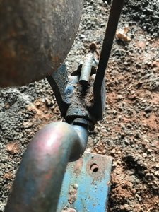

The retaining collar at the bottom of the standard, does it have a piece welded on it that extends up between the side plates of the coulter bracket?
I want to limit the side to side movement of the coulter.

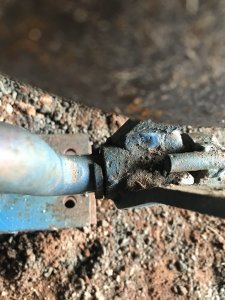

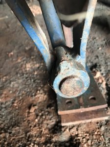

I'll have to look. Its not at my house, its at my sons place. Will get back to you tomorrow, hopefully.

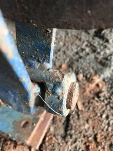

Here are some pictures of the stop on the coulter. Let know if you need any more information.

Once again THANK YOU very much! :thumbs::thumbs::thumbs:
You have answered my questions and provided me with the information I needed.
It is greatly appreciated. Rick
