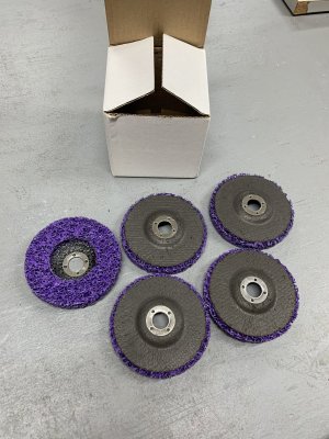

Had a couple of guys on a tractor group recommend these especially for removing paint vs a flap disc. They claim they don’t load up as fast and leave a much better surface for priming. I’ll do a follow up once I use them.CAED8A5B-E0AF-40FB-94F2-3556981D458B.jpeg
Used a ton of the mandrel mount style when I was in the autobody trade. Work really good for removing paint and cleaning metal. I've bought and used 1 disc like you have and they work well but haven't used it enough to see how well they hold up. The disc type is also much firmer/stiffer than the mandrel mount ones. Watch out for sharp edges as you can eat thru a disc in short order.
Had a couple of guys on a tractor group recommend these especially for removing paint vs a flap disc. They claim they don’t load up as fast and leave a much better surface for priming. I’ll do a follow up once I use them.View attachment 66247le
Let the tool do the work, if you apply pressure the disc wears down fast. I use them and they work excellent removing paint. First time i used one 10 years ago my neighbour had given it to me and i polished my anvil to a near mirror finish.
My main reason for these is removing paint. I’m partial to sand blasting things that have a lot of rust. These were from Amazon with a close to 5 star rating and the one that was recommended to me.

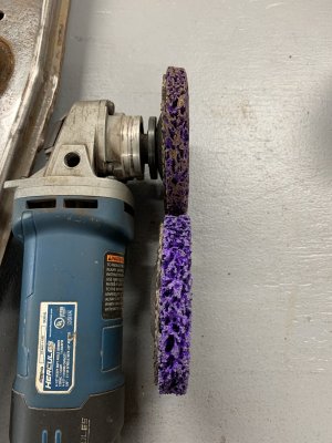

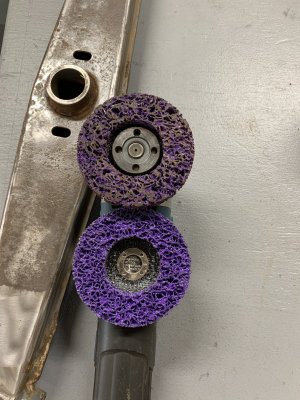

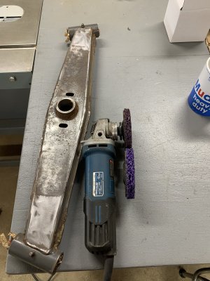

I’m sold on these. I spent about 15 minutes knocking the paint and a little of rust off this pivot bar. I only concentrated on removing the paint. Large flat areas would be best for these. I could see getting in corners would wear the edge down unlike a wire brush. Now I wished I had bought the ten package.

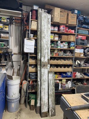

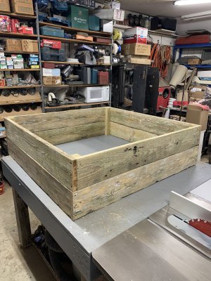

I finally used up the first abrasive wheel. To Noel’s question it’s useless once used up. It’s some kind of plastic fiber pad. I put a new one to clean up some old wooden fence rails for a planter my daughter wants. Knocking off the old paint and weather residue was no match for these. I spent about a half hour and couldn’t notice any wear at all on it. I was concerned about build up but they kind of clean themselves. I did blow it off good when I was done.
