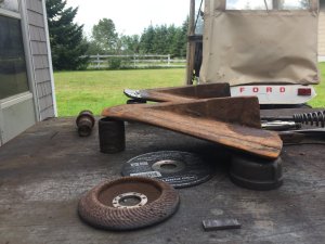

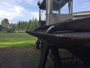

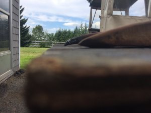

Fixing the points on my two sod

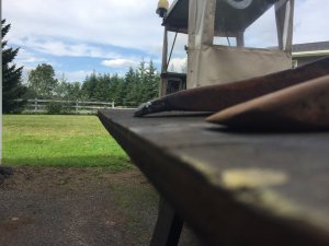

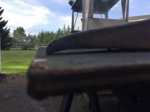

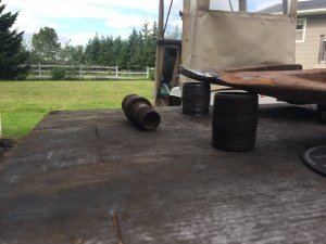

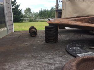

Massey Ferguson plow. Plow match this weekend. So needed to fix the points. These points are not that old and only used at plow matches, one a year, and plowed one 10 acre field with a few other guys just for fun. Wear out quick. Each point was 55 dollars about 5 years ago.
So I have got some suck back under the point. The not fixed one would want to lift the plow out of the ground.

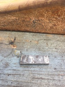

Now remember. I’m not an engineer or a trained welder. Please be easy on me. Hehe. Used a 7014 rod. I really have no idea if that’s good or not. But I believe it’s stronger than a 6013 or so.
I cut up small pieces of an old mower blade for filler.

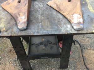

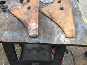

Finished the second one. Not quite the same, as the first one, but has the suck I’m lookin for.
I should win the plow match for sure. Hehe
