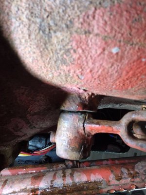

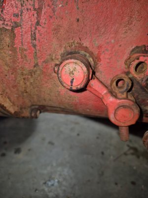

I found a problem, but I’m not sure if it is the whole problem. The clutch release lever has a crack in it. I’m going to order a new one and put it on before I split it. It would be nice if that’s all it is. View attachment 94274View attachment 94275
They actually make new arms still ? Very possible it could be welded..
Hope it comes off relatively easy...

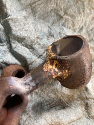

Yes, they are available new. Surprisingly a lot of parts for these tractors are. I’m going to take it off and my dad said he would try welding it. He never welded cast iron before though, so not sure how that’s going to go. We’ve got nothing to lose, it’s no good like it is. I have a new one ordered, and it should be here next week. But if we can get it to hold, I want to use this tractor some this weekend to finish what I started when it broke.
If you have a new one coming don’t waste your time trying to fix it. If you just want to try, brazing would be my first option. If arc welding is easier for you Nickel rod is the easiest to get good results with but is expensive. Non-machineable cast iron rod is inexpensive but turns very hard. Welding cast with regular welding rod makes the cast iron very brittle at the edges of the weld. Whatever you use let it cool slowly.
Good luck.
If you can get it red hot before you weld it, it will help with the welding. When I was in high school one of the kids from another local farm brought in a hand crank corn sheller for FFA day. Towards the end of the day someone broke the cast iron handle. I brought it down to the metal shop and talked to the teacher about it. He said get it red hot in the forge and quickly take it the welding table and weld it up. He got the rods for the welder while I was heating up the handle. Got it red hot, welded it up, let it cool, and then tried it out. Two years later when I graduated they were still using the sheller with the same handle.
Good luck.
Thanks for the info, I think we are going to try brazing it. We don’t have nickel rod, and I’m not going to buy it just for this.
You can get a few nickel rods off of Amazon for under 20 bucks.
We do a tiny bit of cast repair at the shop. Use a rose bud and heat it to 350-400 degrees and weld it. Then lay a fire blanket over it to hold the heat in so it cools slowly. If it cools too fast it will crack.
