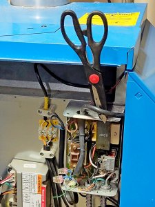

Had some issues with the gas boiler a couple of weeks ago. It wouldn't fire for some reason; everything looked good; the thermostats were calling for heat; the vent opened, but the vent's fan never kicked on, so the boiler never fired. Some wriggling of the Honeywell Aquastat Relay suddenly made the fan turn on.
Okay, problem solved....or so I thought.
On Friday it stopped working again. With the temps in the low teens (F), it soon got cold!
Some more troubleshooting.....I reckon the circuit board has a bad trace. Was contemplating pulling it apart and re-soldering it, when I saw the manufacturing date of the boiler: 2003. 17 years?
Hmm, maybe I should replace the whole relays. Better be safe than fiddling with this unit. Ordered a new one from SupplyHouse; gets here tomorrow.
In the meantime this is my extensive, professional fix using a pair of cheap HF scissors, until I replace the complete relay tomorrow :cool::

Yeah, no kidding! I found the new one on SupplyHouse for ~$210.00 incl. shipping, which is apparently a VERY good price. It's a very specific model too, JUST for this brand and model of boiler!
Anyway, it's all installed as of yesterday afternoon, and the scissors holding the connector just in the right place are therefore no longer needed! ;)
