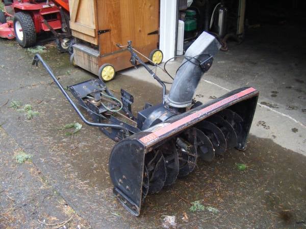

My blower is a MTD model # 190-621. It has a one piece frame and we had to make some modifications to mount it to this tractor. Here are a few of the pieces we made or modified. I had a full thread on this on mytractorforum.com that you can look up in the link below.

Found this video showing how the front mount works.
That. Is. Awesome.
Unfortunately I guess that I got a little too excited, because my setup is a two piece deal, so the speed reduction pulley assembly is separate. Easier to store I guess, but your setup looks like it would take longer to remove the mower deck than it does to mount the blower...
I guess I'll add 'welding on snowblower brackets' to my summer to-do list...
