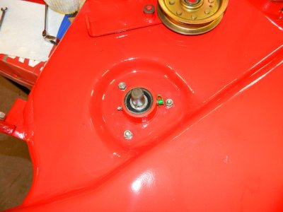

Late to this thread! On the Massey Ferguson 610 deck with my MF12G, there is a sealed bearing on the top and a roller bearing with a lip seal in the bottom of the spindles. They are not greasable from the factory, and of course the roller bearing is subject to fail after years of service. I rebuilt the deck in 2019 using longer roller bearings and added grease zirks and vents. Also pulled the seal out of the inside of the sealed bearings to let fresh grease in. So far so good.
