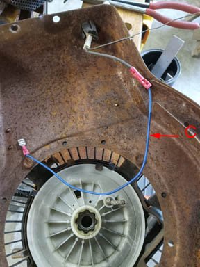

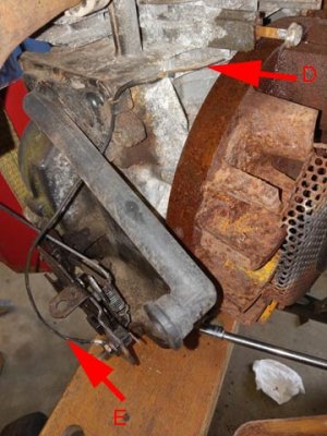

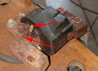

Please verify if I am thinking correctly. On the Coil photo, A is where the original wire was? I can, with a spade connecter attach at B and run to kill switch, which I verified is working. Kill Switch photo is what the wiring looked like as I bought the chipper. The thinner wire was connected to the wire in the Kill Wire photo. Probably do not need that wire in the application that I have? I do not know where wire C was supposed to go.
