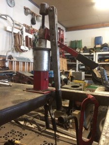

Ive been using one for several years.... have it mounted to a steel table and Ive done several dozen 12" and smaller wheels on it.

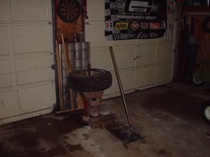

I have a piece of large diameter threaded rod, 7/8 I think, that I clamp in my vice. A couple of nuts and washers holds the wheel on it......and have at 'er with some tire irons. For the 12 inch or bigger tires, I have this old rig...

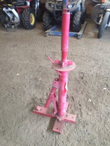

This is mine from Princess Auto.... same thing as the HF ones I believe. I also picked up a larger one a couple years ago but still havent gotten around to mounting it on a pallet
