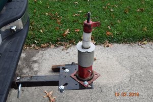

bobcat2
Well, I did end up with one, I didn't install any tires with it yet, but I did break the bead and remove the tires from a front and rear set of rims for my SS12. Other than needing a cheater pipe to get the leverage to break the beads, I think it'll work out fine for as much as I'll use it.
chieffan
Don't care for the receiver hitch set up. To much wobble and can only get 1/2 way around a tire. On a bench corner to use but going on a pipe to drop over the post on a coats manual changer.
