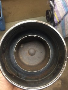

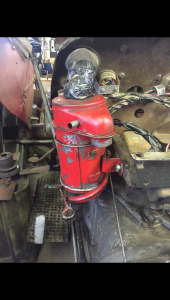

Was cleaning the oil bath air cleaner on the 51 Ferguson tractor, figuring it was a good thing to do before I start the rebuilt engine in a few weeks.

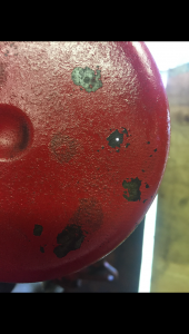

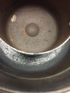

Guess I cleaned it to good. I now have a hole in the part on the bottom, that holds the oil. And I’m sure it’s thin in a few other places.
Any ideas on how to fix. Thanks.

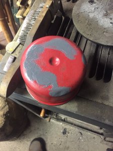

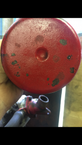

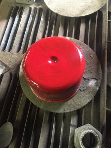

So. I figured it was so thin in spots, that I didn’t want to try a propane torch on it to solder or bronze it because it take more heat to do that.

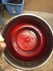

So I cleaned it lightly and put JB weld on the hole and some other thin looking spots. After dry, I put a second coat on. I also did the inside. After all dry, I put Massey Ferguson red paint outside and in. Then a second coat when dry. Should be good for a while. And service it more often to keep the water out of the bottom of it. Who knows if the owners before me ever serviced it. Tractor is 67 years old , I’ve had it for 5 years. I’ve serviced it each year I’ve had it. Just need to look at air filter a little more often, to keep water out.
